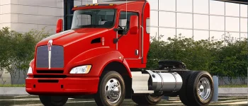

I can't find a good picture of what I'm looking for...this is as close as I can get. Notice this KW cab's rear corner windows...the customer is looking for a window like that in the RR of the
sleeper.

A good suggestion...my concern is structural integrity. I put a call in on Friday asking it's even possible, but so far the Paccar engineers haven't responded to me.
If it's structurally possible in a day cab, why wouldn't it be in a sleeper?
This is the first thing I thought about when the option was mentioned. I was wondering if there might be a bit more of an issue on the corner of a sleeper vs. a day cab.
