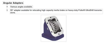

All cost about the same amount of money, the T series pump would be less fabrication but requires a special input shaft.
I have possibly 3 options, only one proven to work.
1.) Mount a remote pump off a drive shaft PTO ( proven to work)
2.) Use an adapter to move PTO away from frame and down from bulge on trans.
3.) Use a pricey T series muncie pump that might not fit.
